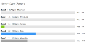

Going there, I walked very fast, my HR was in Zone 1 about 8 min, Zone 2 about 8 min, and less than a minute in zone 3.
Intensity minutes showed 11 minutes moderate, 4 min vigorous.

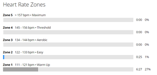

Going back on the return trip I walked at a fairly leisurely pace.  I only made it into Zone 1 for about 6 minutes, less than a minute in Zone 2.  Yet Garmin put the entire 22 min in moderate for intensity minutes.  This makes zero sense and is completely different than the earlier walk.  See screenshots below showing HR during the two walks.

First Walk 11 min moderate, 4 min vigorous
Return Walk

  • Right - but GC shows Intensity Minutes for each activity specifically, in the Stats tab of the activity - so those were calculated for each activity.  I checked - it turned out that I had the option set to the automatic calculation rather than using my chosen zones - so that explains why the results didn't match time in zone.  but it still doesn't explain why a leisurely walk that barely registered any increase in HR would result in 22 min of moderate Intensity Minutes .  There is no way that second walk should have qualified for that purpose.  And if it did, then the first walk should have been even higher.  Something is just not right with these calculations.
