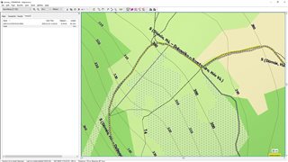

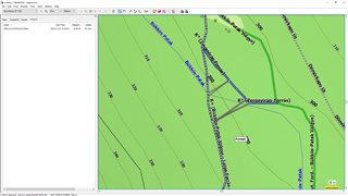

    You are right the track was much smoother, BUT when I diverged from the path by 10-20 m deliberately on a meadow the track was drawn still on the path as if Lock on road had been activated. But it was NOT. I checked it during my hiking. Moreover I found some places where there were some fake positions and in this cases all those trackpoints were placed on the neighboring path.
    Sorry to say, but I have a bad feeling that opting for multiband also includes some extra tweak in the background algorithm, which has nothing to do with L2 and L5, but enforced Lock on Road.
    I dont state Lock on Road is applied always, but it seems that some conditions imply its use.
