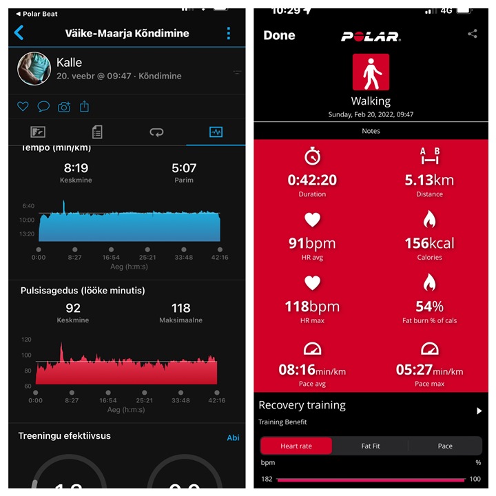

  • here you go
    I tried for a while ... venu 2 (version 45 and 40) venu sq, fenix 7s and now I'm wearing an instinct 2s ... of all the detection is more accurate on instinct, it doesn't seem to catch a beat , both during normal activities and also in training !!
    Venu 2 has always been very precise too, this until a few updates ago ... from then on he began to underestimate the heart rate both at rest and often and willingly also in training, it seems that they cannot solve anyway this problem, although there have been other updates since.
    Fenix 7s accurate in the detection, but perhaps it is my impression ... but it seems that it is however slower in noticing a fast increase in beats, this precisely compared to instinct ... the heart rate sensors are the same both on the venu 2 and on the fenix 7 and on the instinct 2, at this point I think that depending on the device, you change the software that collects and processes the sensor data !!!
