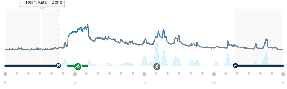

  • That really isn't the case, OHR tracks my activity out of activity fairly accurately. The out of activity peaks in the chart below are up to 127 bpm.
