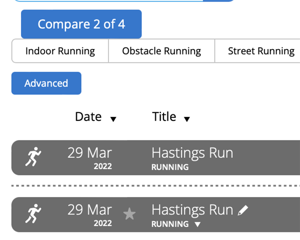

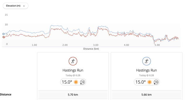

  • Would you post a link to the activity so we can take a look? You can also compare your track and your wife's in Garmin Connect interweb. Add your wife as a Connection. Open her activity from your account. Click the small cog in the top left and select compare.
    You'll then see a list of your activities below hers which will be highlighted.
    Choose yours - it will then become highlighted as well. Select to Compare 2 of 4
    And look at the combined data. You might be able to see where the problem is.
    Check your settings are the same as hers, particularly auto pause if selected.
