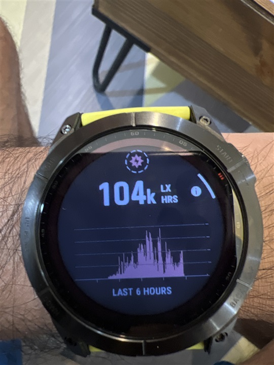

3 hours + outdoors. Got 104k and still not enough to add power to the f7x ss
It's disappointing to see that after 3 hours of charging it didn't get any power.

Years ago a did. some solar testing with my F6xPS: after 7:31 hrs (aborted) I gained only 2% battery. This was in full sun.Attached a pic from the first 4 hrs.
Maybe the solar functionality has increased since then, but the main functionality is still to support the battery to use less battery during an activity.
So the question show much can you get with 2% battery cause that's what you get by giving it a whole day of sun treatment
With my experience today of 3 hours under direct sunlight , I don’t see it helping extend battery if it’s based on battery percentage. The days left didn’t change too.
Just the standard power setting, not battery saver. Yes seems Solar is just a gimmick , not really there to charge significantly or if it can really charge with normal use. Also the outer ring need to be highlighted for Solar to be charging. I see that ring not being full even if you just have a shade for a few seconds. We can’t purposely leave the watch outdoors with direct sunlight for 3 hours everyday to get the extra 9 days.
