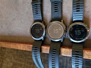

Hello everyone,
Like many people here, I'm torn between choosing Fenix 7 or Epix.
The issue for me is that over time I had very bad experience with OLED smartwatches (delayed and unreliable gesture-to-view, bad battery life with AOD on) and very good experiences with trans-reflective screens (Vivoactive 4, Pebble 2, Pebble Time).
So to make sure I don't make the same mistake yet again, I am thinking of buying a Fenix 7. But I keep reading that the Fenix 7 screen looks dimmer and more washed out than the Fenix 6.
I am thinking it's because of the sapphire lens, because the Vivoactive 4 also has a touchscreen over the trans-reflective display just like the F7 and it looks perfectly clear. But it's indeed possible that the Fenix 7 has a special kind of "denser" touchscreen layer in order to allow operation in wet environments or with gloves, etc.
Does anyone have pictures of them side by side ? I would gladly skip the sapphire lens if that is the culprit and the screen would look better without it (my Vivoactive has a silicone screen protector over regular glass and the display looks perfectly clear but I do wish it was a bit more bright), so if you have pictures of Fenix 7 (non-sapphire) vs Fenix 6 (non-sapphire) or Vivoactive series it would be even better.
Thanks !

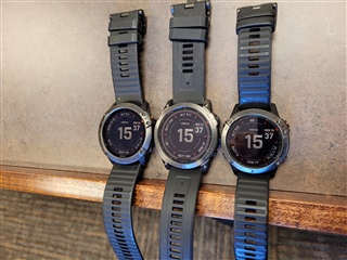

  • It's a tough to get good photos without controlled lighting.  The two photos show from left to right, a f6X Solar, f7X Solar Sapphire, and f6 Sapphire.  The photos were taken at slightly different angles of incidence.  If one would look orthogonal to the watches, the sapphire models have just a bit more reflectivity than the non-sapphire.  As you move off angle, the f7X Sapphire presents more reflection either f6 Sapphire or f6X solar as seen by the photo on the right.  The f7 looks worse in the photo than in reality.  Its certainly not enough for me to send it back.
