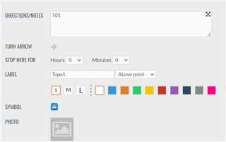

How do you all create courses to follow within a profile?
I do a lot of trail running in mountain areas. I find the course creation rubbish with Garmin Connect so I use Plotaroute. I then add waypoints for the summits and anything else like a water source.
I then save this as a .fit file and upload that to the NEWFILES folder within the GARMIN folder using a PC.
I can then select my trail run profile and the course I created. I can see the distance to the next waypoint etc.
With the purchase of a new F7X Sapphire I thought these waypoints would also be listed in the Up Ahead screen but they're not. Just the start and finish.
Just wondering what everybody else uses to do the same thing?
Also any way of doing this directly from a iPhone or iPad and sending directly to a watch, even using software that's linked to Garmin?

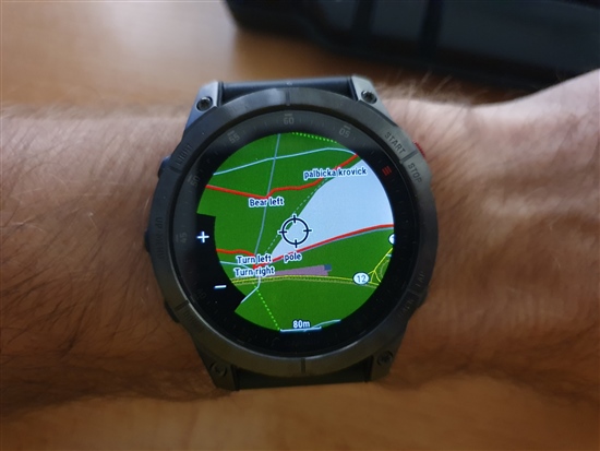

  • Course creation really is a PIA within the Garmin ecosystem. Garmin Explore is getting there but  still has a long way to go. The maps are pretty devoid of detail and often missing many tracks and are not routable. The course created online are painful to create. Better on mobile devices as maps are routable but on my iPhone the screen is too small. If I do succeed in getting a course with waypoints to my watch I end up with a heap of extraneous turn instructions (as has been noted on many occasions). To get around that I need to remove the course from the watch to my PC then out it back in.
  • There was recently an Explore update and the maps (don’t know if all) are routable now. But the created courses may not be the the best ones, because of missing details in the maps.
