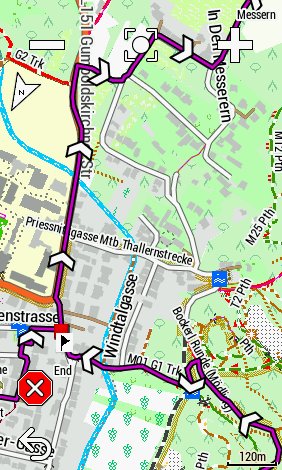

also apparently you implemented this option on your Edge series:

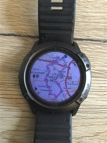

Ah, and your competitor does it very well:
  • On my F6xPS I see it, too.

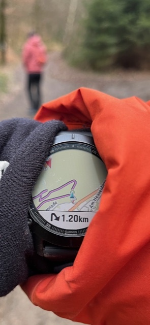

  • Interestingly my Fenix 7 has started showing directional arrows on routes. I don’t know when it started or what caused the change but I noticed it the other day while out on a run. I’ll try and take a picture next time.
