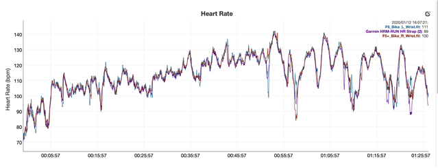

  • So, out for a bike ride this afternoon - F6 on left wrist, F5+ on right wrist both on OHR and a 945 on the handlebars connected to a HRM_Run. A picture saves a thousand words

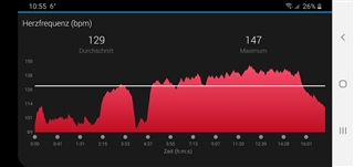

  • Pic 1 it's SW 9.X
    Pic 2 it's SW 10
    Activität Indoor Cycling.
