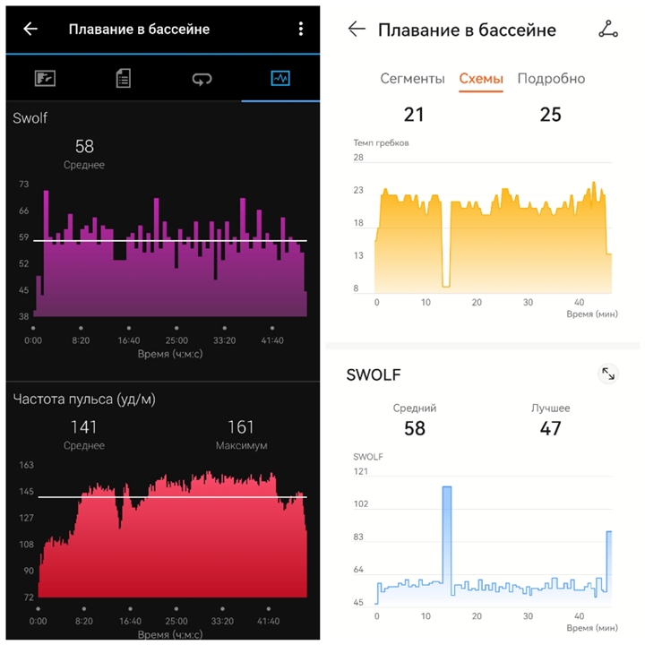

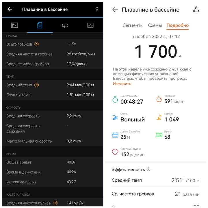

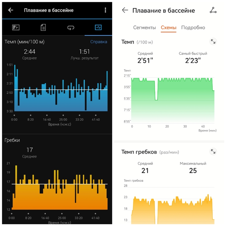

  • Here is some updated comparison from today's swim session. There were no exercises, just a plain freestyle swimming, just a couple of stops to correct glasses position.
    Autorest was set to ON.
    Surprisingly both watches recorded the same 1700m distance, which is a bit of relief to the previous experience.
    Still, amount of strokes recorded differs by 10%, as well as tempo and average stroke measurements. And in this case it's hard to tell which measurements are closer to the truth.

  • Surprisingly both watches recorded the same 1700m distance, which is a bit of relief to the previous experience.
    10 month old reply, but here it is...
    If you average 17 strokes/length and you wear one watch on the left arm and the other on the right arm, you could easily be out by 10% depending on which arm you start pulling with and which arm you reach to touch the walls with (I'm assuming you're doing open turns based on your speeds).
    The 46:24 in "moving time" on your Epix would be used to calculate the pace 2:44/100m. You're other watch used the "total time" (48:27) to calculate the 2:51/100m pace which would be comparable to the Epix "total time" of 48:37 and pace of 2:51.5/100m.  Garmin watches like fast starts, turns, and stops if using Autorest. A slow turn may trigger Autorest and pause the watch for a second or two. 68 lengths x 1.5 seconds is close to the difference between your watch's "moving time" and "total time".  My recommendation if you're going to swim long, continuous swims is to disable Autorest. (or speed up your starts/turns Wink)
