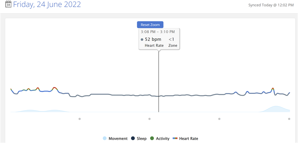

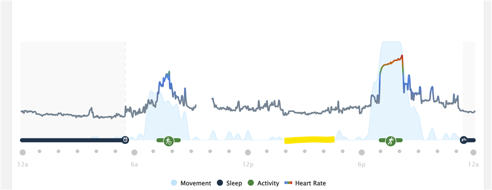

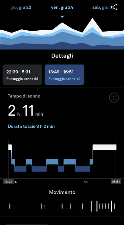

    I went to search for a nap and i found the following one that was pretty long and recorded well by Oura
    In Garmin, there's no trace of any sleep recorded...there's no movement at all and the HR is lower(not like during the night but it's close).
    Zoom on the nap period.
    The sleep starts pretty fine within the schedule...also with higher HR.

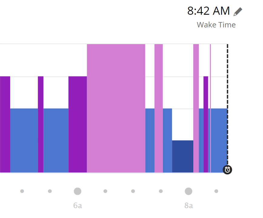

  • A few examples of wrong sleep detection starting when I start watching TV around 9:30pm. I took the screenshots in the morning, before I changed the sleeping time to the actual go-to-bed time (typically right after 11pm). The scheduled sleep period starts at 11pm, but clearly has no effect on sleep detection. There is also clearly no learning process if you adjust your sleeping time subsequently.
    The problem is that the larger pink awake period that precedes the going to bed routine taxes the sleep score significantly, which then taxes the training readiness.
    As described in the beta forum, the new issue with the latest firmware is that sleep history is not adjusted after correcting the sleeping time manually, although the sleep score of that day is modified, but not in the history...
    What a mess...

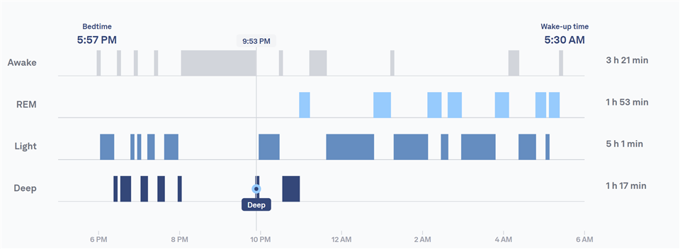

    I have another funny comparison.
    My sleep schedule starts at 9:30/10:00pm and if we use a 3 hours timeframe, as per your worst case, the sleep detection should be more sensitive from 7:00pm.
    So i have this day where i fell asleep between 6pm and 8pm, then i woke up and went to sleep around 10pm.
    For whatever reason, Oura decided to consider it as one sleeping cycle, as you can see.
    On Garmin i have no sleep until 10:08, which matches more or less(10-15 minutes of difference) with Oura's 2nd part.
    The average HR is around 56 between 6-8pm and just a bit of movement.
    So, if we consider again the 3 hours timeframe i would say that 1 hour of sleep(7-8pm) was too short to start the cycle and it was affected by the 2 hours of awake too.

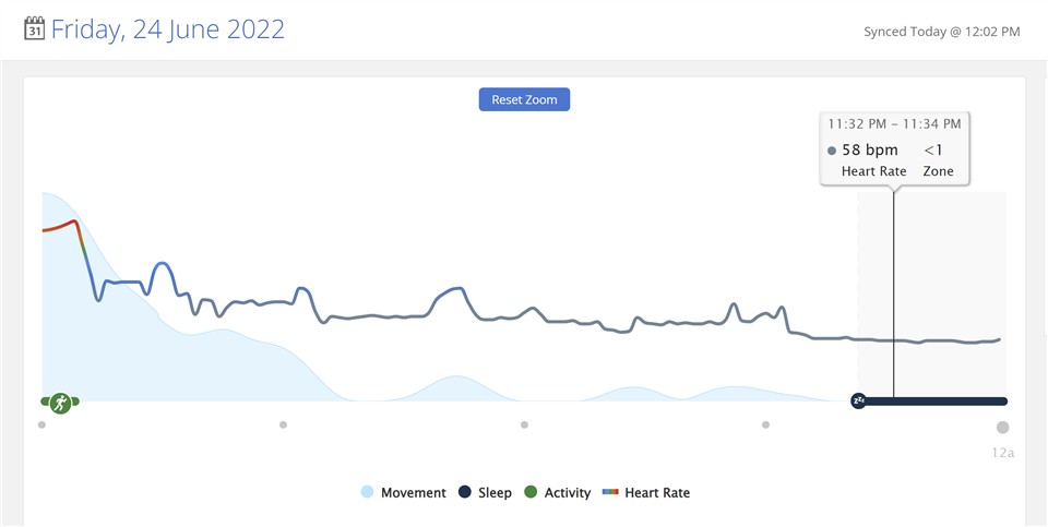

    Did you try to set your sleep schedule a bit later? Let's say around midnight or even 1am? It's not the best solution but could be a nice workaround.
    Out of curiosity, can you post the HR graph around the sleeping period too?
