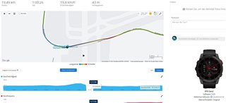

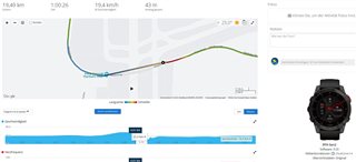

To mention it again. Between Fenix 6 and Epix 2 on one and the same lap are >500m offset at 20km.
Take a look at the pictures. I have 2 tunnels on the way (Frankfurt airport). Both are 200 and min 300m long.
With the Fenix 6 I drive, as with the Epix 2, with 4.63km pure. I come but, correctly, out of the tunnel with ~5.1km.
With the Epix I go in with 4.64 and come out again with 4.67km. That's nonsense. But explains why the devices have such a difference. The Epix can not calculate tunnels out.

  • As you can see here (i cant Upload direct in the answer) with the Fenix6 it was perfect
    abload.de/image.php
    abload.de/image.php
