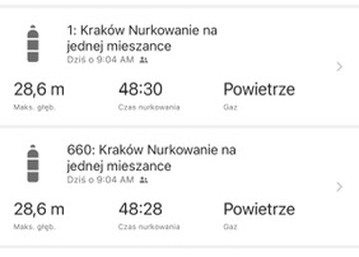

- After a dive, the Garmin Dive app shows one dive as two separate activities.

  • don’t know the answer to question one. I would assume you could delete one of the dives from the app but I am not sure if that will erase on the computer.
