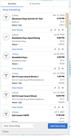

In the web app, both apnea and apnea hunt dives do count towards the total dive count. There's no distinction between scuba and freediving.
So it's either a bug or Garmin is not consistent.

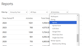

If you want to see the number of dives in GC Web, use Reports » Progress Summary. There, you can select whether you want to see all diving activities, or scuba (resp. apnea, etc.) only:
https://connect.garmin.com/modern/progress-summary
In the dive section in the web app, there's no distinction between scuba and freediving. They both count towards the total. But in the Garmin dive app, apnea is not included in the total. So this seems to be inconsistent or a bug.
By the way, I think this topic would be better suited for the Garmin Dive section rather than wearables, as this bug/inconsistency occurs regardless of the device.
Yes, but if you really need the scuba and apnea dive counts separately, you can still get them in Garmin Connect Web » Reports » Progress Summary.
If you want that Garmin changes the way Garmin Dive works, then I recommend suggesting it to them at Share Ideas | Garmin. However, do not count with any quick reaction, so I am afraid that using the proposed solution is currently your only option (apart from counting the dives manually)
