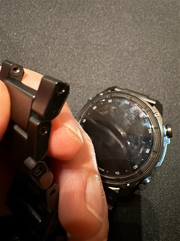

Strangely today one of the screws of my Garmin Carbon Grey DLC Titanium bracelet fell off. Thankfully I was wearing long sleeves and was able to catch it before losing it or scuffing it badly on the asphalt. Never found the screw. And it happens to be the first link screw which appears to be longer and different than the rest, hence i have 3 spare links with corresponding screws i cannot use and an expensive paperweight bracelet i cannot use. Had this bracelet since i bought the mk2i last may, so i have used it roughly 6 months between the mk2i and the mk3i. Previously had also the Titanium bracelet that came with mk1 and for 4 years nothing similar had happened. Seeing design differs a bit between them both i think quality of screws or mechanism somewhat got worse. So if you have the titanium bracelet purchased with mk2 or mk3 watch out not to lose or scratch your watch wearing those
