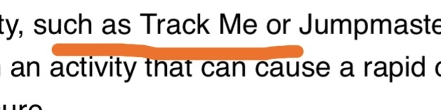

  • When I skydive, I set jumpmaster as support suggested. I have switched power save to extended to avoid the power save mode.
    „it is recommended to start an activity, SUCH AS Track Me OR Jumpmaster…
    „it is recommended to start an activity, SUCH AS Track Me OR Jumpmaster“
    https://support.garmin.com/en-US/?faq=cJL7KD1StQ6p3LqPBGdWw9
    The support article says that you should START an activity. When you START an activity it does NOT go into Power Save mode.
    I suspect that you have called up the activity profile but have NOT started it.
