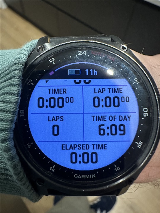

    • Yes as Trux mentioned starting the activity should stop dive mode from starting. Make sure you actually start it after opening the activity. You can create custom activities on the watch adding all the data screens you want to see when the activity is running. This can be done by copying another activity like pool swim and editing from there or just starting from scratch.  Example below of a custom one I made for Freedive in the pool. I use the lap button for counting the laps. You can also add workouts from within the connect app on the phone such as CO2 tables so the watch beeps on your send off time.
