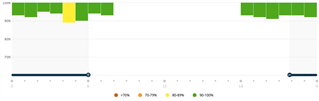

I have my MARQ Expedition set to All-Day Pulse Ox in Garmin Connect and on the device itself:
However, since May 2019, when I purchased the watch, it does not track Pulse Ox all day. Instead, it only tracks at night, morning, and evening. There is always a huge multi-hour gap during the day:
I'd like to point out that this is independent of activity (unlike stress). In the above image, during that gap, I was mostly sitting at a desk at work. In the evening from 18:00-20:30 I was chopping wood and got pulse ox readings. I also don't think that it is because I am at 100% saturation either, as this is consistent for over a year and at varying altitudes.
Here is what it looks like over a multi-day period:
Heart rate, respiration, etc are all tracked regularly and consistently.
Pulse Ox is actually very important for me since I often engage in activities at high altitude. I'm much more concerned with this reading during activities than when asleep, as I don't have sleep apnea.
Am I doing something wrong?

    So far, five days later, no luck:
    I've tried everything except the dreaded factory reset. I'll reach out to Garmin Support and see if they have any recommendations. I'll update the thread if they suggest anything else.

  • This is independent of activity. In the first image of the post, during that gap, I was mostly sitting at a desk at work. In the evening from 18:00-20:30 I was chopping wood and got pulse ox readings. I generally exercise in the mornings and get readings, but during the day, when I am sitting at a desk, I get none.

  • Thanks for the reply, but I’ve debunked that. Activity has no correlation.

  • Just got readings while running 7 miles. I guarantee when I am sitting at my desk later, not moving nearly as much, I won’t get readings. Please don’t throw the manual at me.

  • Hm, @Crispin_Ellison it is interesting that you say it should never record during activity considering that it is an optional activity data field. Why give this functionality if it can't be tracked?
    As for the the time recording in the data files - I'm finding that it isn't correlating to sleep in either direction. Just looking at the past 7 days, it's usually pretty inconsistent in the time gaps:
