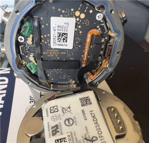

  • I've opened mine since its way past warranty at this point.  It's a 255 mAh battery.  Judging by the amount of room, one should be able to put a slightly bigger battery in there but I'm not sure if the 430 mAh would fit or if there is a size in between available.
  • Do you have some photos that you can send me? I am interested to see if I am amble to change the battery myself. And my 2nd question, did you find a place to buy a battery replacement? I could not...
    Thanks
  • Search on aliexpress, plenty there.  Sorry, I didn't take too many photos.  XK-100005-17001A.  search for garmin fenix battery (or similar).
    https://imgur.com/a/t72CmZd
    https://imgur.com/a/wOQbAXX
  • Thanks for the images. Am I seeing correctly? the battery has a plug in socket that you just need to plug in or it requires soldering?
    Unfortunately I could not find on Aliexpress anything for Fenix 6 or after that code, only for Fenix 5. What is written behind that label? 3,7V with 255mAh?
