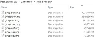

I have noticed that o MARQ watches there is img file named gmaprda.img that is not present on Fenix 5 plus series. Even after deleting the gmaprda.img file maps still work. Could someone please explain what this "Road Drawing Accelerator" file does, is it mandatory and why it has not been included on Fenix 5 plus?

  • Thank you for your thoughts. I have also compared the img files from both watches. This is on "old" 2018.20 TOPO Europe maps, but as you can see the main map files are same size on MARQ and on Fenix 5 plus. gmapdem1, gmapsup1, gmapsup2, gmapsup3 are for golf courses. If something was separated from the main maps, the size of two main img files would be different, but it is just the big gmaprda.img file that has been added on MARQ (same on FR945).
