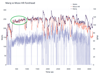

  • I did a comparison with the Polar H10 and the Marq for an easy bike ride (no way it has a chance with a hard ride):
    The segment circled was a flat section of road with continuous pedaling.  Not bad.

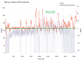

    But here is the difference between the two:
    Every time I coasted, the heart rate stayed high on the Marq

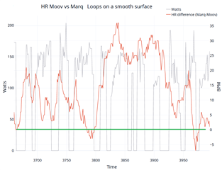

    Here is a series of loops on a perfectly flat pavement with coasting between easy segments
    So it seems that the Marq does not respond to rate change well.  Possibly ok on a steady interval, smooth pavement or indoors.  Not good outside with road vibration.
