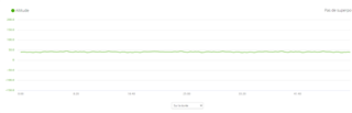

experimenting a lot of incorrect Altitude recording I try to catch some clues here with your help.
My Instinct record each time this time of infos below with a "bump" at the beginning and following flat.
the "real" graph should be
Reading the forum it seems that there some problems with the Altimeter and Barometer
I recalibrate Altimeter and Barometer with the GPS without any positive changes
I'm now in V17.5 product version but there's no changes
could you help me ?
