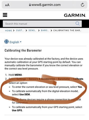

What prevents you from calibrating the elevation with DEM ?
Arrogance. Let the Garmin perform itself! And I do not even know what the DEM is. And my old stupidphone does not know it either.
