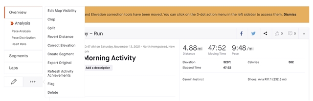

    now garmin is lined up with strava! I can use the pace now to pace myself on my watch during the run. Friday run is using other activity, the others are using run activity. See it under report 2%, that is 11-13 sec difference for pacing per mile.

    I see the elevation for Friday other activity run is a little high, to make sure, I correct the elevation in strava, same distance, so no noice data in my test.
    why strava report 3.15 and garmin has 3.14? In fit file distance calculated is 5060.65, that is 3.1445.... I guess there are difference in rounding decimals when connect 1746 entry of gps’s dot.
