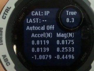

  • Did you check it in test mode? (Switch the watch on while the "ABC" key is pressed for about 20 sec).
    The compass needs working 3D accelerometer and 3D magnetometer.
  • Great idea. Did not think of it. In fact, test mode shows that  both sensors are working in all three dimensions, but it may allow me to try to determine which direction is misbehaving (if that is the case). Thank you.
