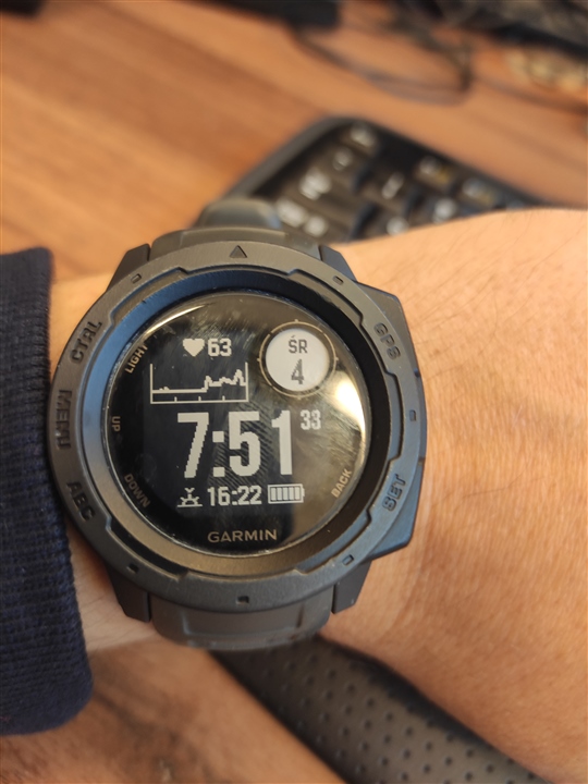

I have the same issue. Battery bar stays full for days till the battery eventually runs out. Did a full recharge, reset etc.. battery bar still does not change. The rest of the watch seems to be functioning properly and total battery life is good, I just have no idea when I need to recharge unless I just guess or wait till it eventually dies.
Can you share a picture or screenshot of your battery bar on full so that we know we are all talking about the same thing?
Thank you in advance.
Here's a pic. I last full charged it on Saturday night. Even without using GPS and whatnot it should have at least one bar down. On Saturday it died with a drained battery after showing me full charge for 1.5 - 2 weeks of wearing it.
My watch too :)
What does the test mode show about the battery?
(Hold the ABC button during switching on).
Maybe the battery measuring is simply defective in your watch.
