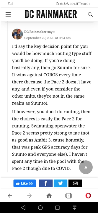

    DcRainmaker commenting that peak GPS accuracy was the Ambit 3 days.
