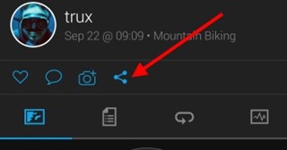

  • Yes, it looks like the watch either acquired an additional satellite at the end of the red section (or lost a connection to one), and as a consequence it adjusted the position couple of meters. However, including such GPG repositioning to the speed calculation is a clear algorithmical glitch, so I would recommend contacting the Support and also the development team at [email protected], and reporting the glitch to them.
    Include the screenshots, and also the link to he activity - they will need it. You can get it by tapping the Share symbol on the Activity page, selecting the option Web Link, and sending it to yourself. Or easier - open the Activity in Garmin Connect Web, and copy the address line from the top of the browser.
