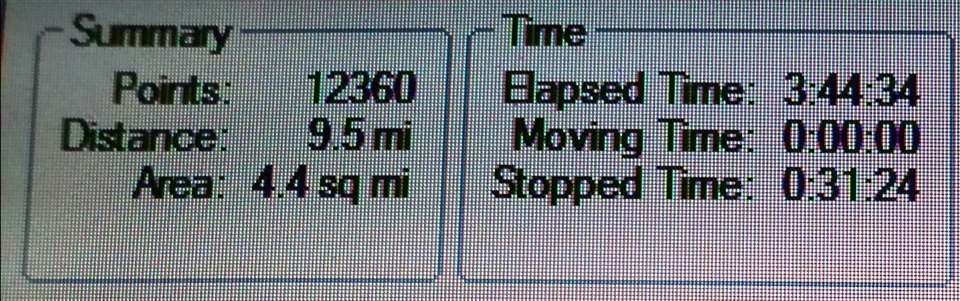

    Here is an example from the weekend of the Instinct performing well.  Instinct (top) vs Ambit3 (bottom)
