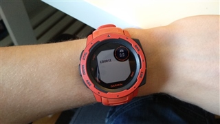

Hi,
I have made a course just to know where I want to run. I am inside of the running activity and I have set one of the data fields to be course. I don't know how I can set the course that I have made to be displayed there. I DON'T want to "do course" i just want it to be displayed there. I have downloaded it to my watch and I can see it, but don't know how to set it there. Plz look at the images I have inserted here:
