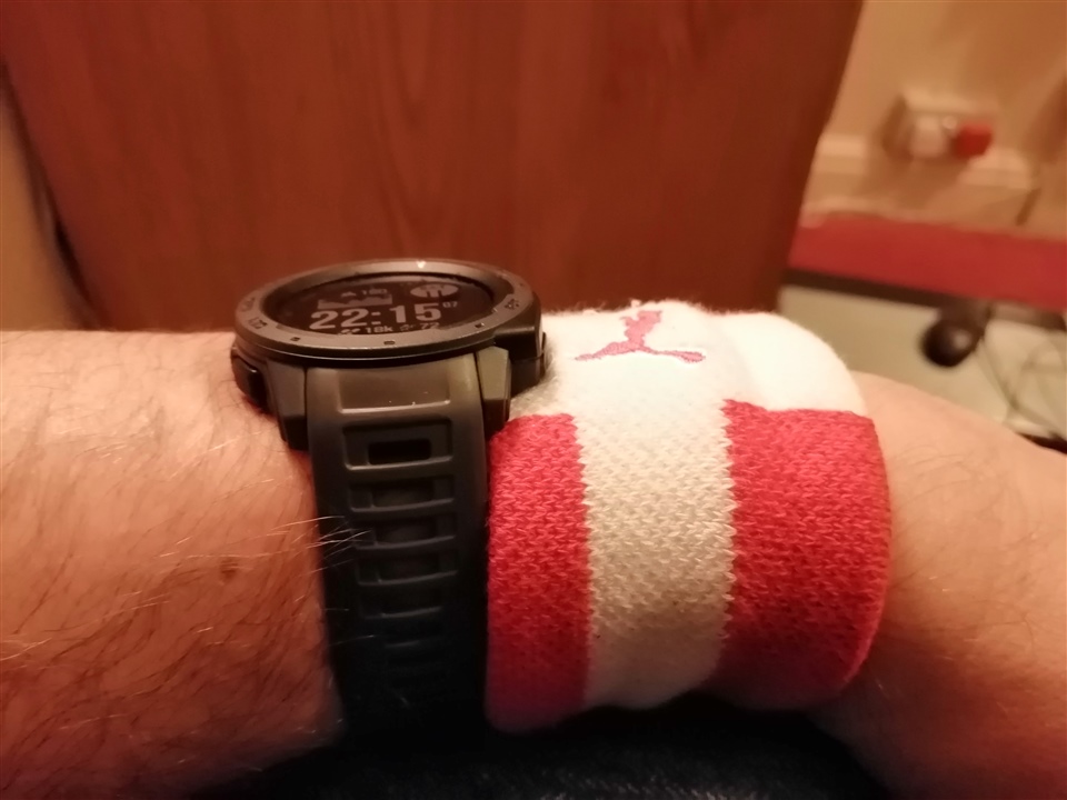

This was one of my posts from an earlier thread "Elevation Problem":
Here is my low-tech, inelegant solution... that actually works pretty well.
It is just the top of a sock - cutoff. It does not impact the OHR, though I get poor results from it during activities (so I use a strap).
Thank you for your great solution to a major issue with the barometer/altimeter.
Sweat bands I ordered arrived today so have already implemented your idea.
Can still get heart rate and keeps the sensor from getting blocked
It actually keeps the watch in a better position for heart rate higher up the wrist without slipping down.
Works really well, just how the watch should have worked.
Nice! I might have to switch to a proper wrist band, as I can see that it would help keep the watch properly positioned for better OHR results.
I also switched my Instinct to "Altimeter mode" a while back, which seemed to provide better results too.
Any sweat wristband should work, just put it on then line the wrist strap parralel to the sweatband and then tighten with the watch overlapping.

Hi, thank you.
Difference in distance is meaningless in this case, only 0.02 mi.
On the other hand, elevation chart is noticeably smoother, and more accurate with the tape on, so A+ for that solution.
It's easy, cheap and effective.
On a side note pace chart was a lot more rough in the second run though, but that is more "on" the runner than "on" the device itself.
