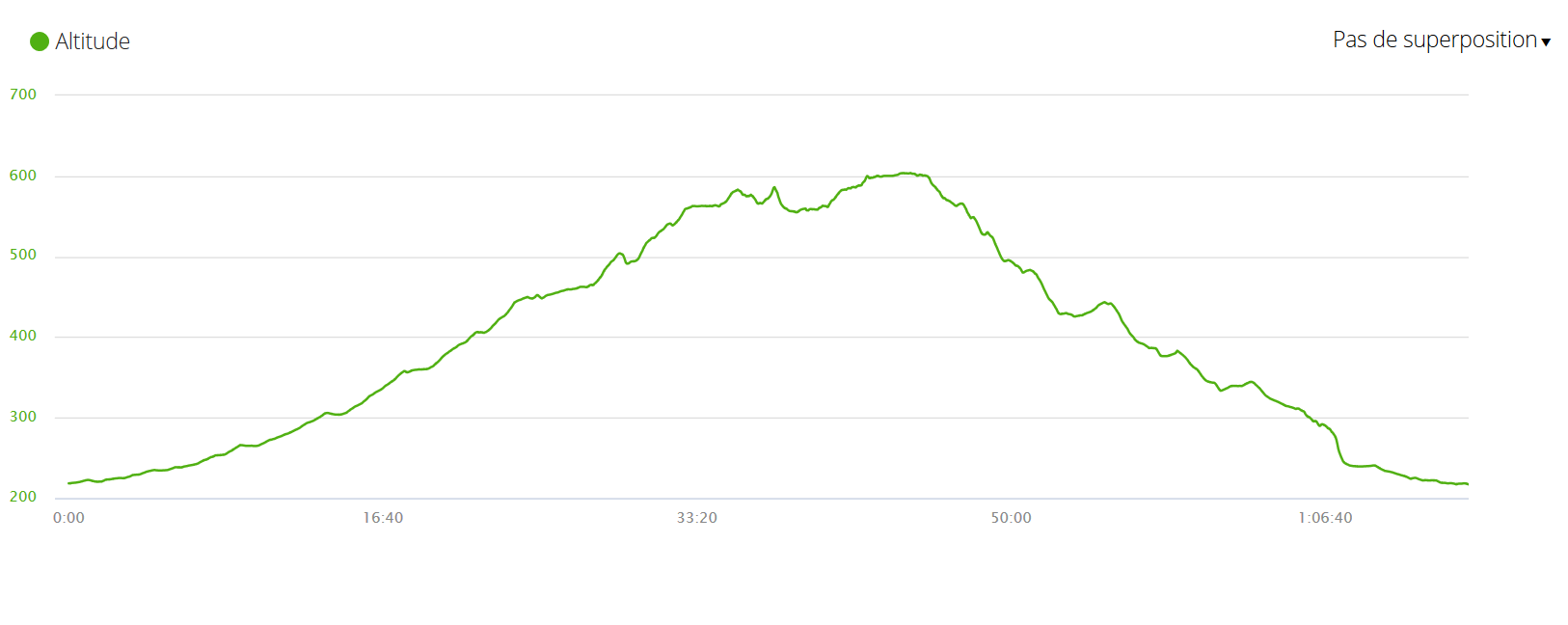

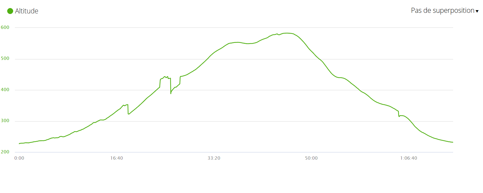

Hi everyone,
For a few weeks now I noticed that the elevation data are really smoothed a lot and that because of this it doesn't catch any ascent/descent smaller than 30m.
2 days ago I kept looking at my Instinct during such a little ascent and the elevation continued decreasing (around -15m) instead of increasing (around +17m).
You can see this between 52' and 55' of the data. I put the original data (whith barometric altimeter) and the data with elevation correction of GC. On the overall the global ascent with the Instinct is 365m intead of 461m !
Has anyone observed the same ? I would say it is since 3.10 software (but not completely sure).
I saw on the forum that FR935 and Fenix 5 already had the same kind of bug that has been fixed afterwards but it would be strange from Garmin that now they introduce this same bug in the Instinct...
I also have some glitches (eg between 26' and 28') but this is not new and the glitch is filtered so that it is not included in the total ascent/descent.
ciq.forums.garmin.com/.../1474147.png ciq.forums.garmin.com/.../1474148.png
