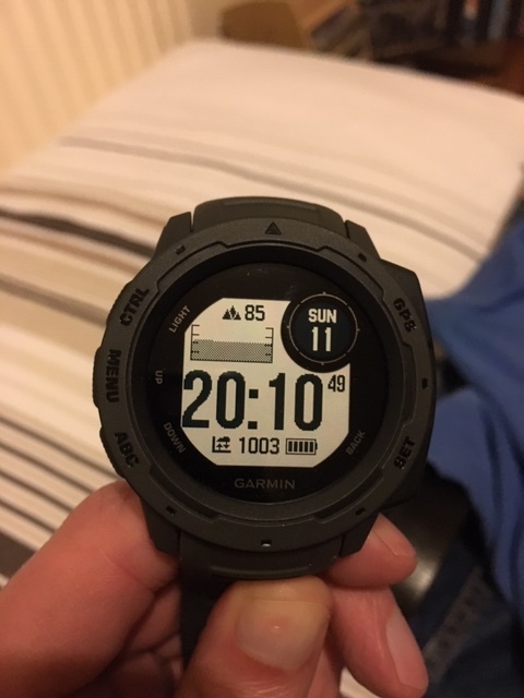

  • One other thing I’ve noticed is that using the screen with big digital numbers and 24 hr setting the left side is almost off the screen, not sure if it’s a bug, screen is not misaligned as all other screens line up perfectly.
    In most lights it looks off the screen and also depending on angle. Other times like 17:00 etc are fine as digits are not so wide I guess.
    Anyone else’s like this? Can you guys check for me?
    Many thanks.
    I’ve attached a pic.ciq.forums.garmin.com/.../1423512.jpg

    Perfectly normal. If you want 24-hour time with more space on the left side, try using Military style time: MENU>Settings>System>Time>Time Format>Military
    HTH
  • Many thanks once again for your reply.
    Good to know they are all like it. Set to Military time now.
    Something they can maybe fix in an update as it’s so near the edge that in most light it looks off the screen and the 2 appears cut off.
    The font slightly smaller would fix that when in 24hr mode.
