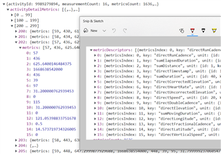

  • Yes, there is indeed something wrong with your watch. Below, there is a screenshot of the JSON data of your activity. There is no speed (value #8) and no moving time (value #11), at any of the track points. Normally, those fields are populated.
