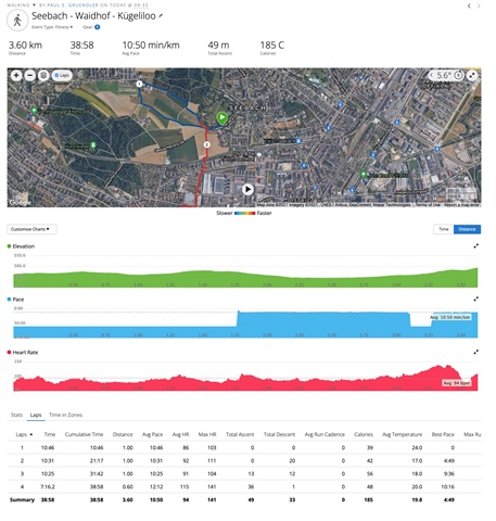

Walking Pace dropping out but GPS drawings are correct
Hi I found that on walking activities the pace drops out and comes again.
As you may see the GPS assigned track after the upload is on the way I was walking. There is also a the time for each auto lap km assigned
Garmin Instinct Solar V16.00
Laps
Time
Cumulative Time
Distance
Avg Pace
Avg HR
Max HR
Total Ascent
Total Descent
Avg Run Cadence
Calories
Best Pace
Max Run Cadence
Moving Time
Avg Moving Pace
1
10:46
10:46
1.00
10:46
86
103
0
0
0
39
0
0
0
2
10:31
21:17
1.00
10:31
92
111
0
20
0
42
4:49
0
2:45
2:45
3
10:25
31:42
1.00
10:25
91
104
13
12
0
56
9:36
0
10:25
10:25
4
7:16.2
38:58
0.60
12:12
115
141
36
1
0
48
10:16
0
5:12
8:44
Summary
38:58
38:58
3.60
10:50
94
141
49
33
0
185
4:49
0
18:22
5:07

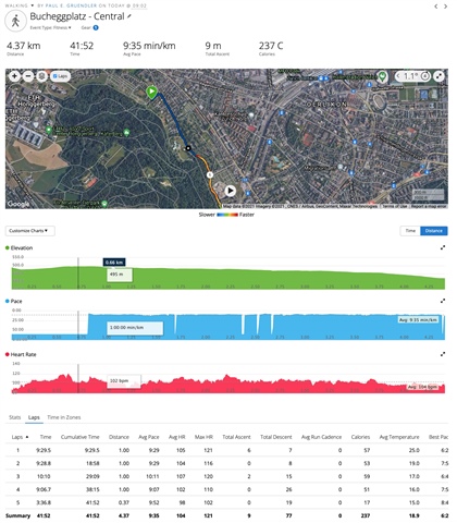

  • I had the same problem today. When I checked the watch after 800m it was not showing the pace. Then I run for a few meters and the pace did show up on on the watch and did stay active until the end of my walking.For me it looks like the watch needs a certain speed to get the pace working.
    The funny thing is, the track does match my way and the time and distance matches the reality, but the graphic for the first 800m is showing something else.
