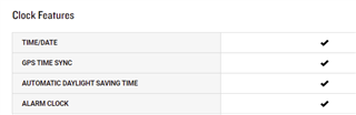

    I did as you suggested by acquiring a GPS lock.  The alarm did indeed go off this morning at the correct time.  I'm still a bit confused why that step would be necessary.  The clock time was correct when the alarm misbehaved.  I don't think I should have tp grab a GPS lock to account for Daylight savings time.  Spec below.
    Anyway, thanks for the suggestion.
