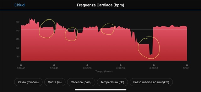

Hi,
I did two runs and noticed that HR locked several time on both as you can see in the picture. It seems that HR locks for some seconds in a value then it resumes spiking lowly or highly. I run with chest strap.
Hi,
Which model chest strap do you have? Could be the battery needs to be replaced or the device is approaching imminent failure.
I have the Decathlon one: Kalenji Dual ANT+/ Bluetooth
It shouldn’t be the strap. I don’t think is going to break/fail because it has worked perfectly with my previous Suunto 5 that I returned a week ago.
Thanks for the info. Just needed to include that in the troubleshooting in case anyone has any other suggestions. Battery replacement usually comes up as a possibility. If it's like the Garmin straps, they're usually a CR2032 battery. Easy to replace. At least you could then rule that out as the issue.
Ok i will try. Do you suggest me to remove the battery after each run?
I don't think that is normally necessary. I have a Garmin HRM-Run it will sometimes act strange like this if it gets excessively wet from sweat or rain. In that case I take the cover off and let it sit for a week to make sure the insides are completely dry before the next use. I just use a different strap during that time.
