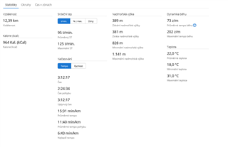

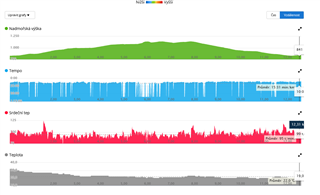

I run a loop, hence I expect ascent and descent to be the same, but they are wildly inconsistent. These are my last 4 runs (all along the same route):
| Date | orig. Ascent | orig. Descent | Adjusted in Garmin Connect | Height profile |
| 07.03 | +26 | -56 | +-53 | ![]() |
| 12.03 | +43 | -80 | +-44 | ![]() |
| 28.03 | +50 | -102 | +-50 | ![]() |
| 30.03 | +42 | -102 | +-42 | ![]() |
Also, is GPS not used for determining height at all? Even with "calibration during activity" I return far below where I started...
