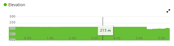

    Looks like you misunderstood the experiment I have shown. The sweat is causing the steep drops of elevation shown in the previous screenshots of @henzim.  The same drops shown on the elevation profile from my liquid experiment.
    The steady elevation shift is rather caused by the change of temperature and/or by the changes of the atmospheric pressure (though I would not completely exclude the build up of sweat either). I am not sure how it is with Instinct Solar, but with the standard Instinct, a change of just a few of °C results in the difference of tens of meters. It could be that the firmware of Instinct Solar is better thermally calibrated, but perhaps also not.
    You can do another simple experiment -  start a dummy activity, let the watch sitting on a desk (same elevation, stable temperature), wait till the internal temperature and the elevation stabilize, and then expose the watch to some temperature changes (warming up, cooling down). My watch shows deviations to +/- 50m in such experiment. Note: you have to do the experiment preferably outdoors or with an open window, to exclude the influence of air pressure fluctuations in a closed room.
    Also look up the weather data for your location for exactly the time of your activity, and find out what the atm. pressure was at the moment of the start of the activity, and at the end. A millibar of pressure increase will result in the drop of elevation of roughly two meters
  • That's why I think if the Solar is so inaccurate, the altimeter is defective.
    If the altimeter were defective, it would not record the elevation correctly when worn in the bag, as  wrote. The deviations clearly come from external factors like the temperature, wind gusts, the sweat, and/or the wrong position/fit of the watch on the wrist, otherwise it would not show diametrically different profiles when protected from the external factors vs. when worn on the wrist.

    I do not tell it was not improved. It is possible. However, if Henzim's Instinct shows significant errors only when worn on the wrist, while it records the elevation correctly when in the bag, then the altimeter seems to be working all right, and rather the external conditions are the culprit.

    BTW, try doing the same controlled experiment with your Solar, as I posted previously: sit motionless at the desk, with the Instinct firmly attached to your wrist. Start a Walk activity (never mind the GPS lock). Wait 5 minutes to see whether the elevation is stable. Then pour some luke-warm or body-warm water on your wrist near the pressure sensor opening (better have a towel or a recipient under the arm ready). You can make some light wrist movements to simulate the running. Wait 2 more minutes, and stop & save the activity. Then post the elevation profile it recorded. Would be interesting to see whether there is really a difference here between the Solar and non-Solar versions.
