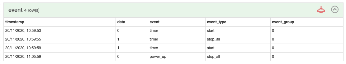

  • OK, just to add some more information to the situation: Out of interest I copied the FIT files off the device for the 2 activities in question, and viewed them with the utility at "www.fitfileviewer.com".
    There are events that happened within both activities described as event=power_up and event_type=stop_all. These occurred exactly where the activities were stopped.
    See the attached images.
    Do these events indicate an issue? I have looked at other FIT files and they do not have these "power_up" event types listed. Is my device rebooting? Could a factory reset help? Should I venture into the world of beta testing the new version 12 Beta?

  • It seems that your watch crashed and rebooted as I mentioned in some of my post about crashing while mountaineering with navigation and swimming and you didn’t start the activity after reboot.
