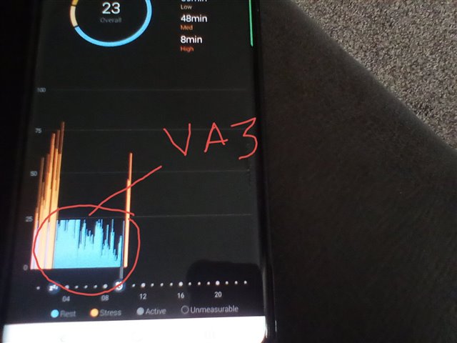

I wear my watch as tight as I can handle but I still notice big gaps in the graph for my stress score on Garmin connect
Is this a software issue or a hardware issue, when I first got the watch my stress score graph was continuous without any gaps
Take last night I have a gap of 2 hours while I was sleeping
That could be easily caused by exactly the fact you claimed at the beginning "I wear my watch as tight as I can handle"…
It would be interesting to see the data from both devices for the same night. You'd need to create a second GC account for the VA, so that they could record the data both in the same time, each into its…
I meant the very same night, so that it is sure you compare apples to apples and not to oranges. If you then have two different results for the very same night, mail it to Garmin Support, and have them…
The watch does not measure the stress when you are active, since the values could be misleading, while influenced by the physical activity. Perhaps at the original version the threshold for the activity was set differently, or you were less active during the day - that could explain the difference.
That could be easily caused by exactly the fact you claimed at the beginning "I wear my watch as tight as I can handle". You are not supposed to. The fit should be firm, but not too tight to limit the blood circulation. In the night, especially if you are a snorer or suffer from sleep apnoea, or have a cold and obstructed breathing pathways, the hypoxia caused by it, will induce periferal vasoconstrction, limiting the blood circulation even more, which may then hinder the proper HR and/or HRV data recording.
I meant the very same night, so that it is sure you compare apples to apples and not to oranges. If you then have two different results for the very same night, mail it to Garmin Support, and have them create a case with it. Using data from two different night won't help them to identify the cause.
It's just strange the older VA3 seems to monitor stress better
That's a question. Perhpas it is not better, perhaps it just interpolates the values when it cannot measure anything. Which in principle is worse tha showing no data, although it may look better.
