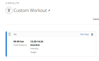

And you can also use the Workout feature - creating a workout for 100 km (99.99 is actually the maximum I managed to enter when testing it) and the desired pace range. For the Walk activity type, you have to select the Workout type "Custom".
Once you start the workout from your Walk activity menu » Training » Workouts » your workout » Do Workout, there will be an additional screen with a graphical pace indicator showing you whether you are within the planned pace range. See a screenshot from my Instinct (it may look better on your Fenix):
