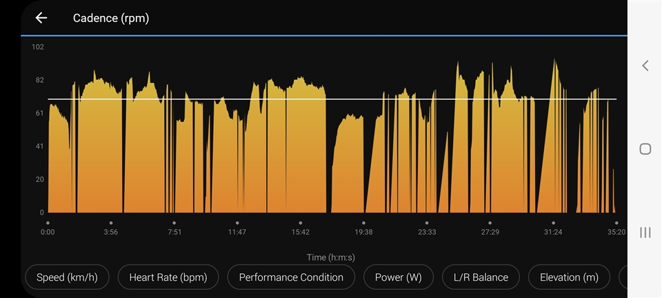

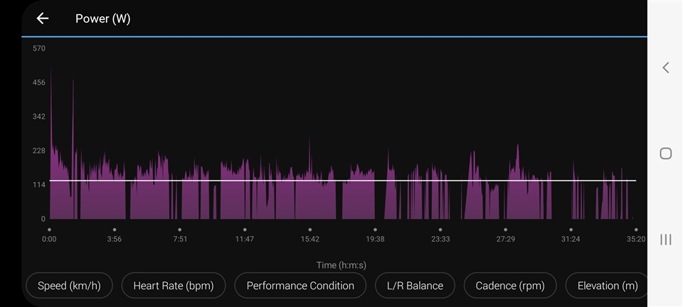

After trying reset, connect,disconnect , change in battery, BLE, ANT connecion etc for fenix 5 and 4iiii 5 months, I found out that my fenix 5 cant handle input from both.
Pict 1- power meter plus HRM pro
Pict 2- power meter alone.

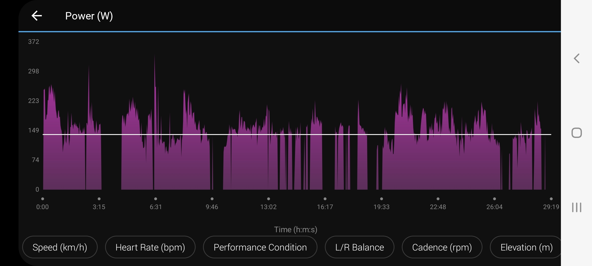

Yes, there were multiple occasions where power meter report cadence only but not power ( I notice live on fenix 5 display ). Two cadence reports of power meter from those two activities, with or without HRM pro
I will try to remove and reconnect again with with version 25 fenix 5 software again today ( Already did those stuffs dozen times before).
Those are power meter and cadance reports of today ride.

To prevent power meter's NULL algorithim kicking in ( minimum cadence input in 4iiii is 30 rpm and smoothness is set in 3 secs), I tried to ride as smooth as possible and tried not to interrupt longer than 3 seconds. However, I saw live on fenix 5 display that both power meter and cadance randomly dropped out for a certain period.
This power meter reading with Hrm pro is much better than the previous one but according to my experience, the random drop in power meter connection is less just after reset and then keep get more and more later.
