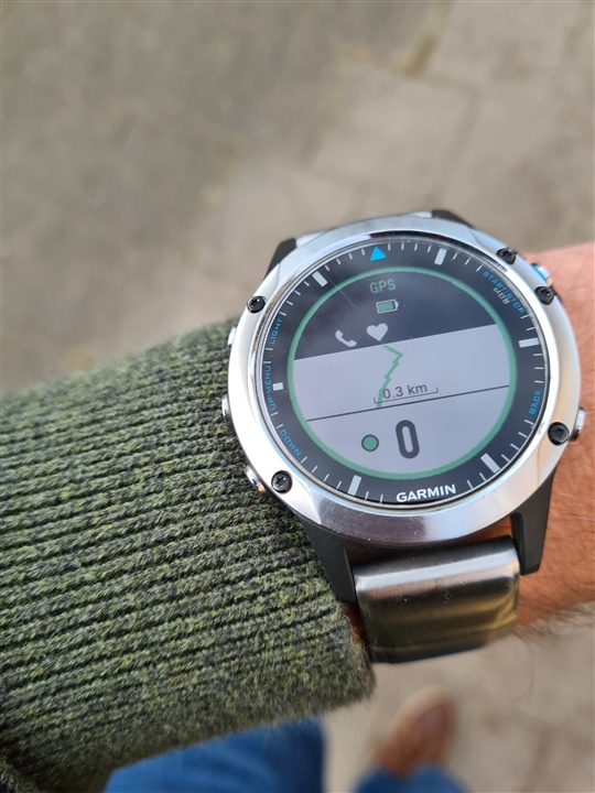

  • The mystery still isn't solved. More often than not, I keep seeing the green dot and the distance to starting point during the whole route, while I should be seeing the distance that I still have to do.
    However, I do have new evidence. I made a photo standing in the exact spot where my route started. As you can see, distance to start is 0 meters. And still, the green dot won't disappear. Any thoughts?
