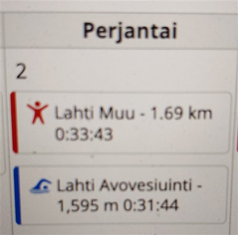

Attached is a photo of exactly the same OWS from July 2nd. Downloaded from the watch both the watch and Garmin Connect show distance 1595 meters. After downloading the GPX file to my computer and uploading it back to Garmin Connect, the distance is 100 meters longer 1690 meters. How does Garmin explain this? I assume the time difference between the same two files is explained by the file type. GPX ignores breaks/stops. It only shows timestamps.
