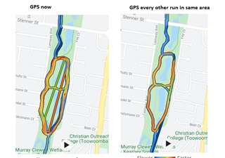

My Fenix 5x hasn't had the best GPS accuracy since I have used it but in the past few weeks (starting late November 2020) it has been terrible.
The maps on Garmin connect and Strava show that the run starts 500m+ after pressing start (I always wait for GPS to be found before starting). The distance on the watch starts increasing straight away though. This seems to happen on every run now.
At the finish it seems to record weird 'jump backs' to an earlier spot. So at the finish spot it was show multiple kind of zig zags back and forth from the finish spot to one 500m back.
If I press pause/stop and then move away from the location before pressing save it records a single point where I pressed save. This has never happened previously but now happens regularly. So I might stop the run and then drive halfway home and press save while driving it adds a straight line from the finish to this spot.
Additionally random GPS drops where there has been none at all in the past.

    I have tried a soft reset but it has happened again since. It doesn't happen every single run but seems to be most of the time now. Strange that the distance starts immediately counting on the watch but the map track doesn't begin where the watch was started.

    Thanks for the info. I have now tried a hard reset which didnt have any affect - still problems. This morning I tried rolling back the firmware to v13 and still problems persist. I might contact Garmin Support.

    I have figured out a workaround so far - record a 5+ min run activity and discard before starting the proper run. This seems to have worked the past week. I have been just starting a run activity 5 mins before my run and discarding rather than saving. Once this is done I start the run again and the tracks record properly. Still quite annoying having to do this.
