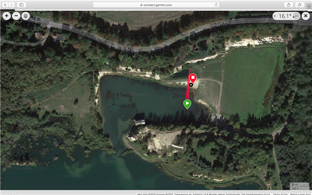

Very bad Fenix 5 tracks for open water swimming
I have lots of tracks like that with my Fenix 5
https://connect.garmin.com/modern/activity/5158739515
All software updates did not help.
Does anybody know how to get better tracks. Glonass? Galileo? Sync with Garmin Express?

    I’m just starting open water swimming as the pools are closed and finding the same issue.
    Last night my wife and I swam together in a lake, her Suunto 9 tracked that she was doing the right distance of about 340 meters, and we did 3 loops, and my Fenix 5x tracked I did a total of 161 meters!!

  • My swims are identical to yours in the picture. looks like I spend my time on land...frikken useless F5s

    That's interesting as I had mine set to GPS yesterday when I went for my swim and had it locking to GPS before I went in this was how Garmin saw my 3 laps of the top lake!
    I was going to try GPS+Glonass next
