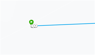

As a test I also made a straight line of 10km on the Suunto site and exported it as GPX.  Then I imported it in Garmin Connect.  Imagine my surprise when Garmin Connect indicated this is a 20km06 long course. Yes twenty km.

  • I didn't import the same route twice.  But as you can see the "first" 10km are within a few metres of the start.
  • It seems that there is an error in the GPX file. To solve this issue have a look into the GPX and analyze what is going wrong.
  • I've downloaded the GPX from Garmin Connect also.  In both GPX-files there are 2 coordinates and they are identical.  I did the same thing with a straight line of 288km and itlso doubled in distance on Garmin Connect.  I also did the same thing using Alltrails and it also doubled in distance
