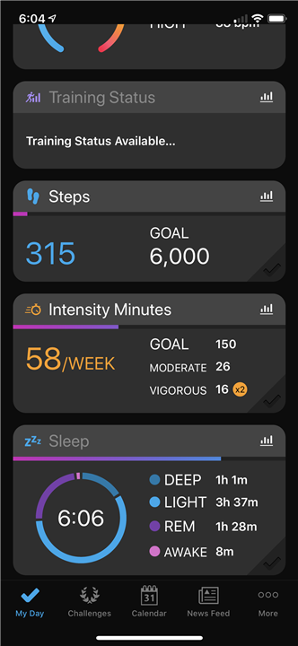

Tonight, I went for an outdoor ride and had all my sensors connected to my Edge 830 (speed/Cad, Power, HR, etc)-all of them, BTW, that have been connected to the F5X in the past as well.  I rode for 65 minutes at a casual pace (average HR was 134 bpm), temp was cold (29F avg, 25F min), in the dark.  F5X was on my wrist, securely held to my arm by the watch band, and further held secure by my jacket.  The HR was recorded, as can be seen below:
As you can see below, there is no 'auto-detect' activity that took place.  However, the Edge recorded and uploaded the activity just fine on it's own (like it normally does-I start and stop the activity).

  • Yep, on both devices.  Just did another 1-1/2 hour ride in the cold today and ZERO intensity minutes assigned.  WTH Garmin, quit breaking your functionality-serioulsy!  This used to work just fine...
  • So I just tried this today (recording on both my Fenix 5X and my Edge 830)-the result: I got about 20 minutes worth of intensity minutes for a 1:40 ride with an average HR of 141 (both devices connected to my HR chest strap).
    I can't help but think there must be something weird with recording Intensity minutes out in the cold weather because this seems to have gone haywire since the temps have dropped.  Additionally, I get about 20 minutes worth of Intensity minutes when I'm scrub my hair in the shower!  No, I'm not scrubbing the whole time-the elevated temp and my residual elevated HR (post ride) are seemingly enough to register 'Intensity minutes'.
